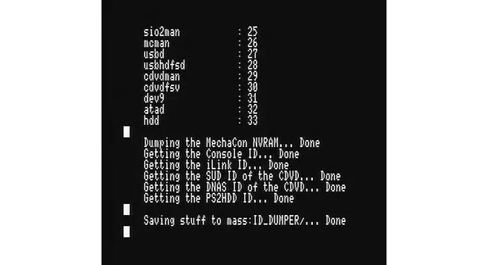

    A little PS2 ELF which was coded for the sole purpose of dumping the machine and iLink IDs, the CDVD keys (DNA$ and SUD), and the $ONY HDD ID. It also reads the entire MECHACON NVRAM...
    The dumped data are saved as raw binaries to the USB drive.
    To dump your PS2HDD ID, you need three $ONY drivers (dev9.irx, atad.irx and hdd.irx), NOT INCLUDED in this package. The download comes free of $ONY proprietary code.
