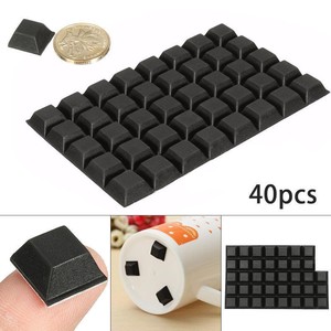

    Search in ebay for "adhesive rubber feet"... like the ones of this photo are ok
    The requirements you should try fulfill are:
    -the rubber needs to be soft (because you dont want the PS3 to slide and fall to the floor when pulling from USB cables and things like that)
    -height should be 1cm or so (mines recycled from a router are only 5mm though, but seems to be good enought)
    -The rubber feets needs to have an adhesive layer (to stick them easilly)
    Contras
    The bottom of PS3 slim gets hot, the adhesive "melts", and the rubber "moves" from his original position
    At least this is what happened with mines... i guess this depends of the adhesive material, but when choosing a model of rubber fets probably you are not going to be given info about the adhesive quality... so is like a lottery i guess
    Alternativelly... there are rubber feets without adhesive and has a hole for a screw
    The PS3 has screws at bottom, so i guess is posible to keep them in place with the screws (if needed replacing the screws by longer ones)

    @sandungas Well, I don't have access to Ebay (look in my profile), anyway I was lucky enough. I found these rubber pads in perfect condition. We installed several switches at work, but we didn't use the pads because we have a rack. Anyway these days the temperature is really high and I decided to set the fan speed to 45% (constant) to keep the PS3 around 66C. The fan noise is bearable. Will the control fan help the console lifespan? I assume yes, I don't want to have a nightmare messing with IHS at all. I know this will happen eventually though.
    Thanks for your tips.
