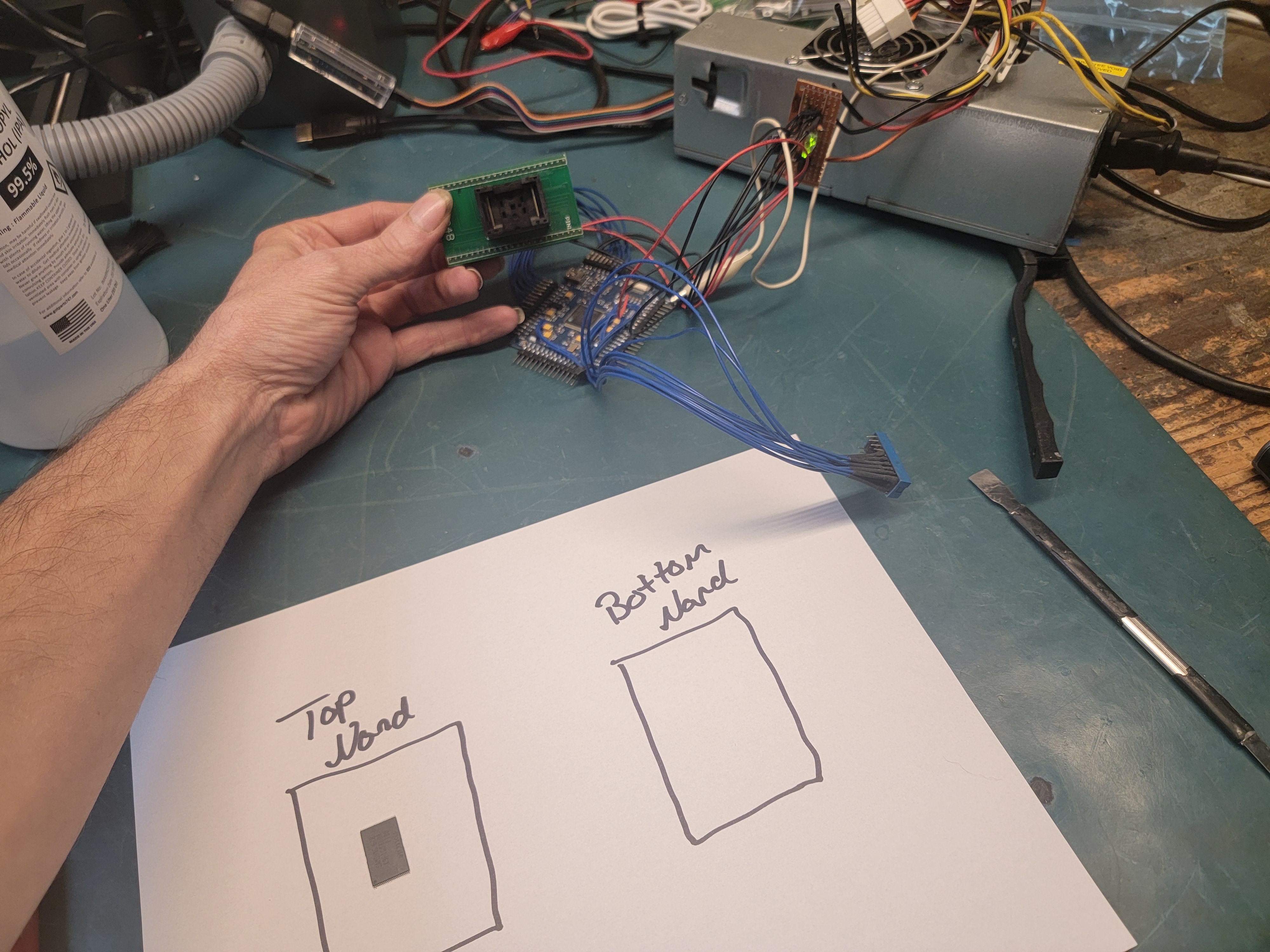

Welp guess ill dump the nands with my old skeeter LOL this thing is wild looking jsut unboxed it and 10 years dust off the thing wondering if i got that firmware 3.55 problem no idea this console was YLOD
Damn this frankenstien setup made me big bucks 10 / 15 years ago at the shop LOL, Lucky for me i saved the workstation and it still works everything isntalled and ready to go! Hahah

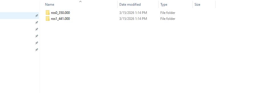

Welp ROS1 bank is on 4.41 so i guess that GLOD is the RSX or something else ills wap the RSX again came from a working SLIM stragne
