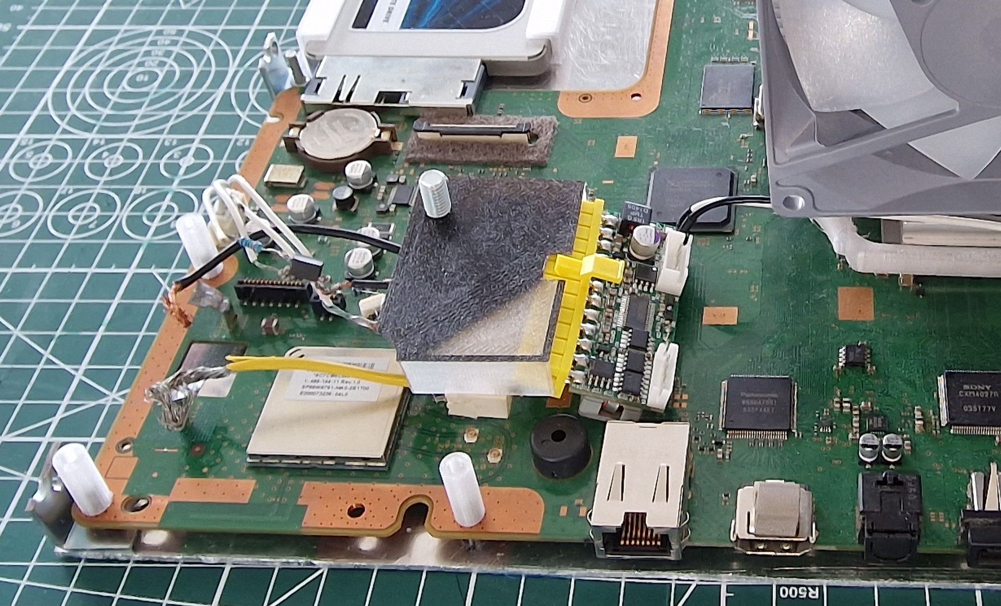

3. Connect PC fans to PS3 motherboard
The next stage now is soldering a connector together that will be able to connect the motherboard to the PC cooling fans on the PS3 cooling towers. For this I will use the 3-pin connector that comes with the built-in PS3 Slim fan(Note that it is slightly different when compared to a standard PC 3 pin connector), cut it off and solder two connectors that support a PC fan. You can find diagrams on PS Dev.
WARNING: Make sure to check the amps your PS3 fan needs and make sure the PC fans do not exceed that amperage. E.g. My PS3 fan specs is 12 volts and 1.6amps. My PC fans need 12 volts but each fan needs 0.3 amps.
4. Version 1.0
With everything ready (for the most part) now I need to attach the support bracket to the mother board but I also wanted to keep those metal plates that support the motherboard the ones it is sandwiched between. No issue with the bottom thin sheet but the top had to be modified so that I could attach the cooling bracket to it, solution? I introduced it to the angle grinder and sliced a gap big enough for the cooling bracket. I wish I had a bandsaw for a cleaner result but beggars cant be chooser.
I put it together and forgot about the blue ray drive which sadly doesn't fit in the PS3 Slim case with the cooling bracket nevertheless I never planned to use it as part of this first build anyway. The next stage is to put on the thermal paste, attach the fans and start it up.
Overall even without the blue ray drive I did not see any issues the console turns on fans work and by the looks of it multiMAN is able to control the fan speed. (I wish I could turn off the fans just for a second to confirm this but multiMAN doesnt have that option.)

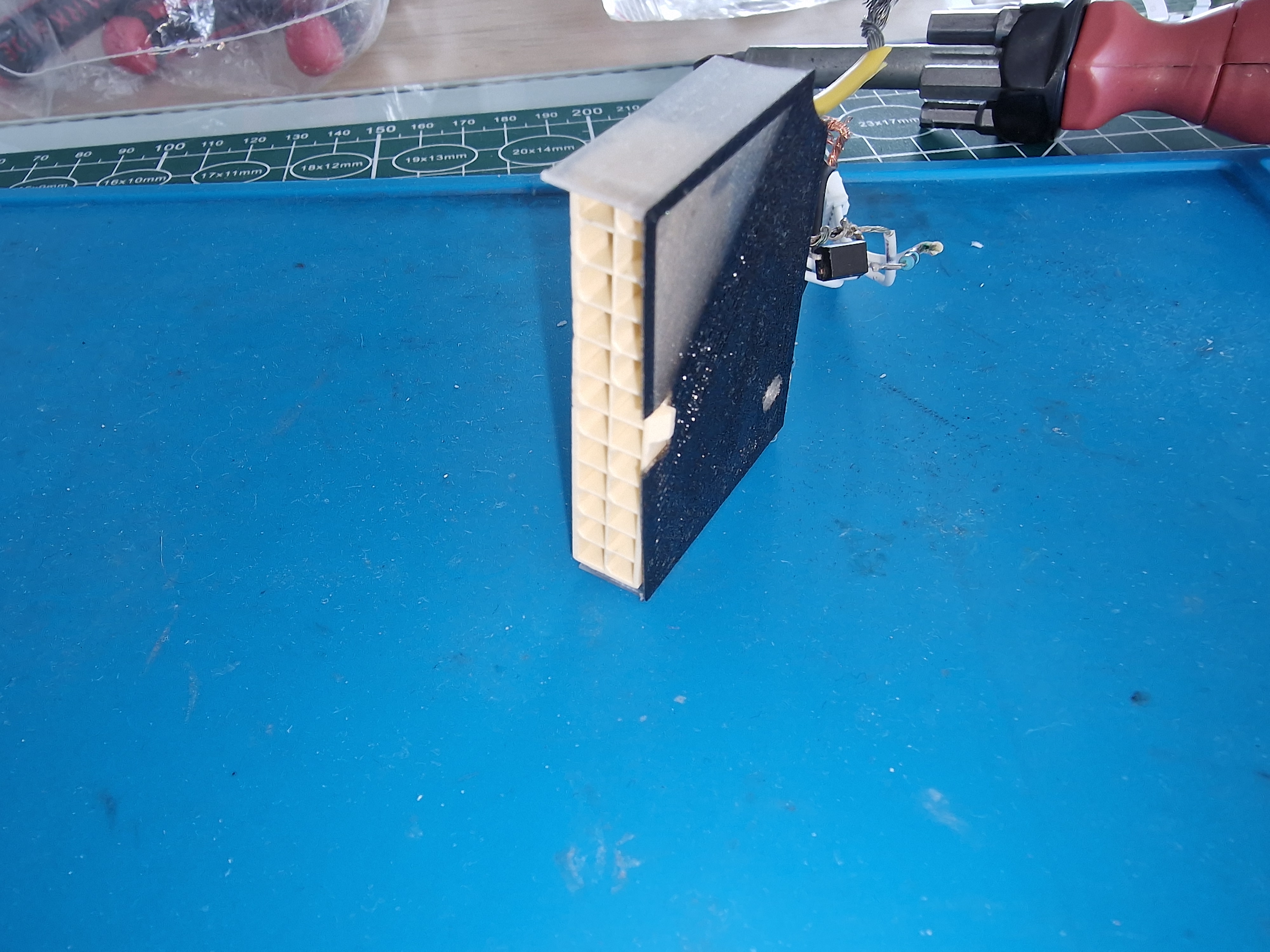

2. Custom Cooling Bracket
As for the cooling I decided to go a bit further so instead of cutting a hole in the PS3's case and calling it a day I tried to figure out a way on how to attach those PC cooling towers on to the CPU & GPU. The goal here was to create a system that would look as such; 1 – motherboard, 2 – support bracket, and 3 – coolers, similar to how PC's do it, simple and easy to use. I came across a number of issues that complicated the process, first I wanted to use one big cooler but then realised that there was a height difference between the CPU & GPU so I would need to weld a plate to the cooling unit and that would simply not do.
So, I decided to use 2 separate smaller cooling towers one for the CPU & one for the GPU but I came across the issue of needing to attach 2 cooling units close to each but thankfully I found slim cooling towers for PC online for about €8 each. However the reason I chose these tower coolers was not only because of their slim profile but also due to them having latches meaning that I did not have to screw these coolers to anything a simple AM4 upper bracket would keep it in place. Furthermore the base of the cooler that comes into contact with the CPU/GPU was 35x45mm on these towers, a little too small compared to the needed 41x41mm but checking into the delidding aspect of the PS3 it turned out that the silver squares are just heatsinks and the real processor is underneath so I guess you don't have to cover the entire processor, a 45x35mm base should suffice in theory and each processor will have its cooling unit which should be more than enough.
Now I had the general measurements for the future coolers and the goal of creating a support bracket for them that can be attached directly to the motherboard which had an AM4 bracket built-in or at least AM4 latches. To securely screw on the custom bracket to the motherboard I planned on using the M6 holes located around the CPU & GPU that on the original design are used to press the processors into the metal plate under the cooling fan.
To create this bracket, I knew someone with a 3D printer and all I needed now was the ability to 3D model. (Insert Eye of the Tiger and training montage) After 2 weeks I managed to learn the basics of FreeCAD and moved on to modelling the bracket. After another 3 weeks of errors, getting the needed measurements and the destruction of multiple 3D printed test versions I came to this result (image below) which turned out decent. The cooling towers are firmly held in place and overall it turned out not as bad as I expected. I might make a few minor adjustments if required however. The bracket is specifically made and tested on motherboard version JSD-001 I have not tested it on other versions.

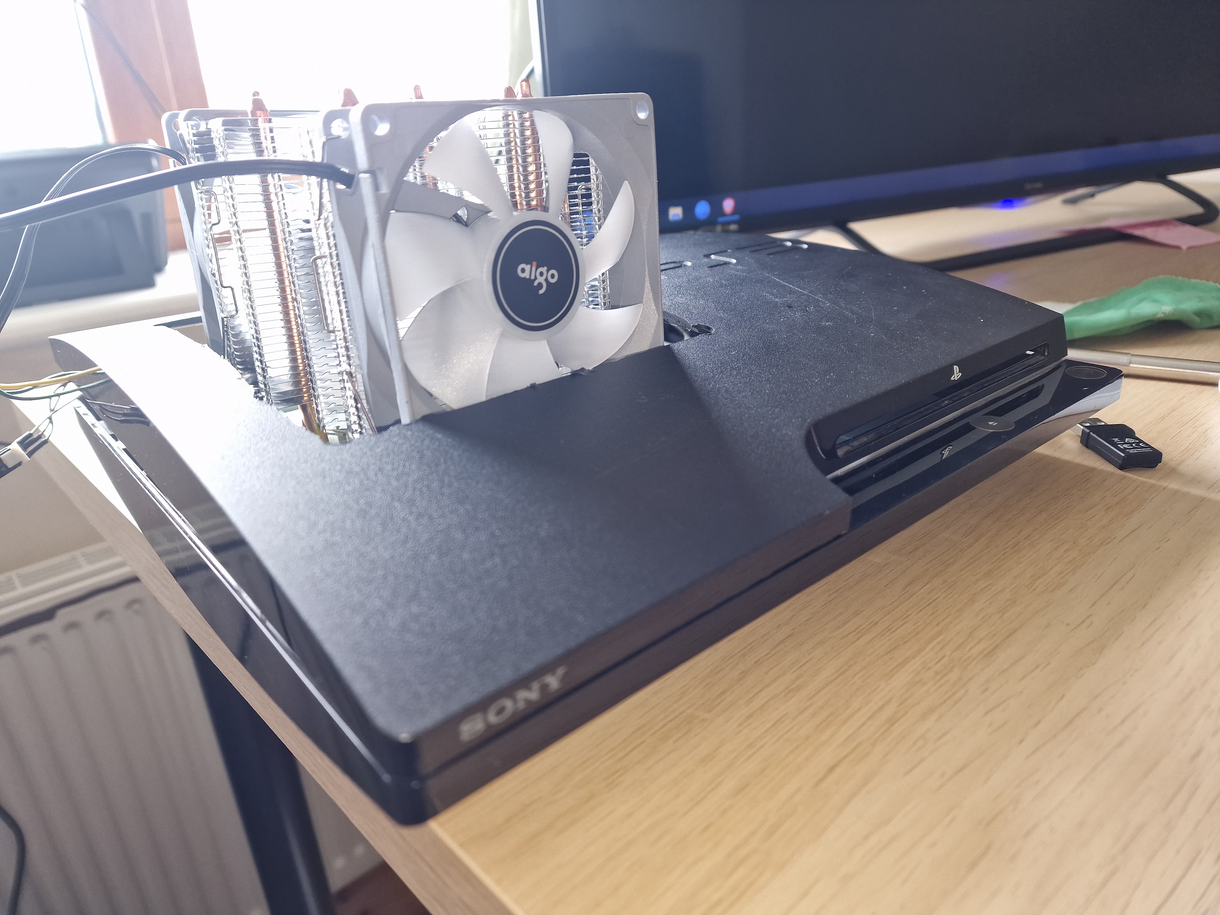

4. Version 1.0

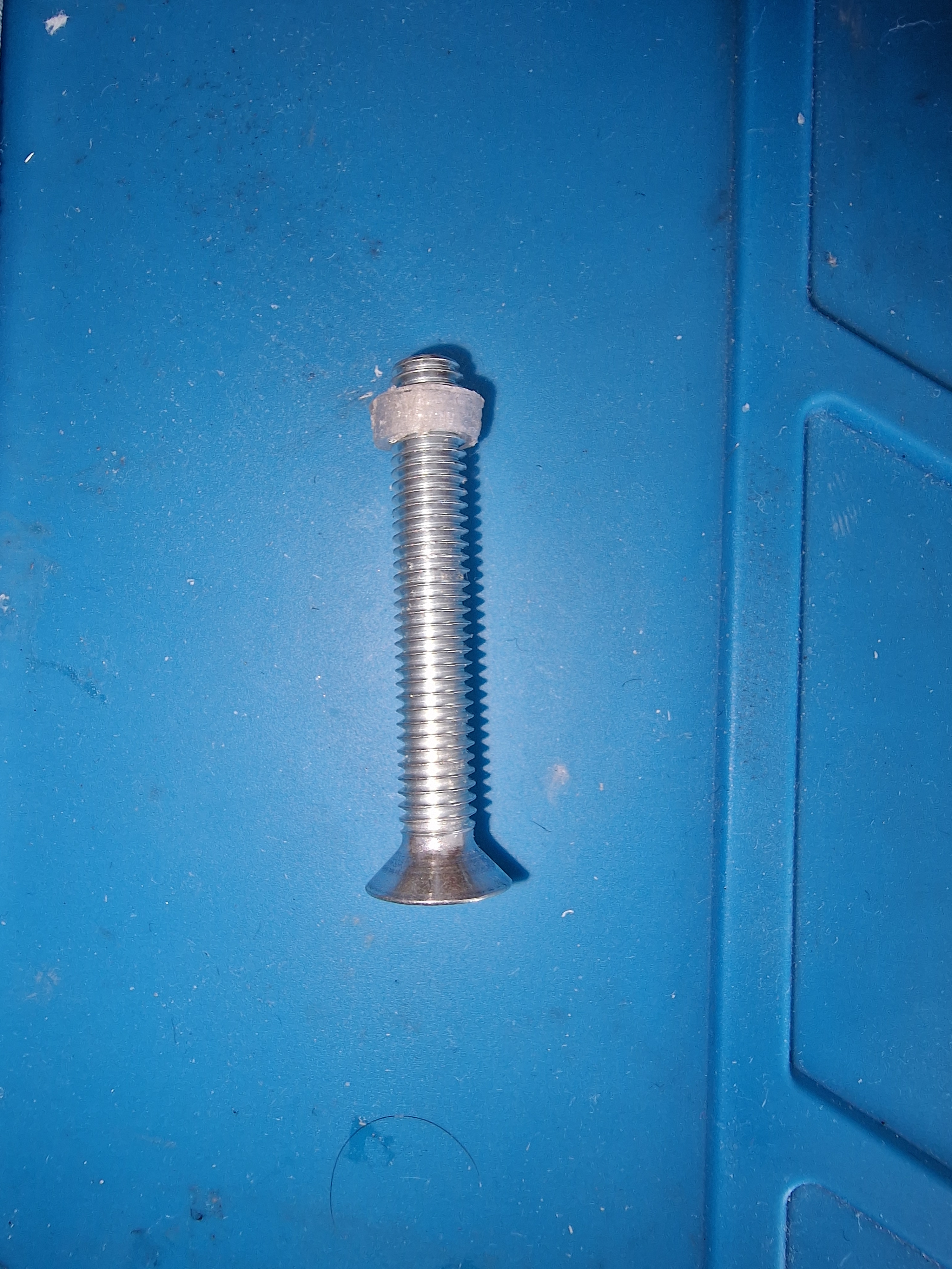

The process of attaching the heatsink bracket did not change. I used a countersunk screw this time and 3D printed a few additions for the the 4 countersunk screws to make the whole thing look neater. (Check out the images below)
