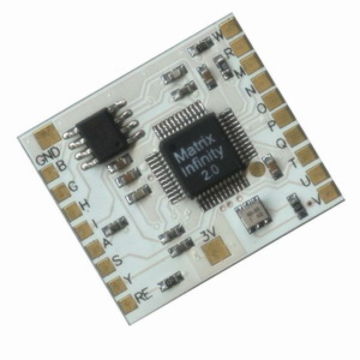

    wLaunchELF 41e4ebe (14\01\2019) version is not working on 90004 with hard modded ps2

    Which modchip and do other versions work?

    Did you tried to disable modchip?
    For Matrix Infinity:
    BTW you've on FMCB 1.966 (13\04\2019) or on 1.953?

    I found that problem is FMCB. I ve tested with FMCB 1.953 It's worked.

    I don't know if you were able to disable modchip,
    so I can only add that some rev of FMCB might incompatible with some modchips (especially clones).
    Is it actually a Matrix Infinity?
    Recently I've seen version 2.0:
    From what I remember the last official FW-Update for the MI is 1.93:

    When i disabled modchip on 1.966 Launcher was worked.
    My modchip is MI 1.93. I dont know clone or real. But I installed many time diffirent version since FMCB 1.8 to diffirent console with modbo(clone MI) and matrix inifity modchiped ps2. I ve never seen that launcer doesnt work. Also I tried old version of uLE on 1.966.
    You know if i would install another modchip (except MI and Clones) FMCB never work. That means after FMCB 1.953 something is changed and that effect to launcher working

    Since it is a SCPH-90004, I think the modchip is most likely a clone...
