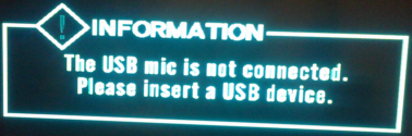

When mic is out this message should appear almost at start after checking memory card:
