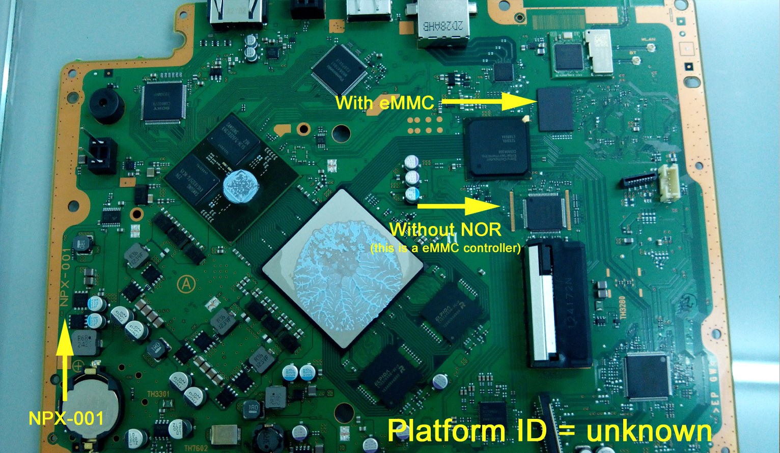

I made a couple of images to show you the trick we was using to figure how many platformId's there are , and how sony assigned them to the different PS3 superslim motherboards
We search google for images of the motherboard name (in this case a NPX-001)... and keep attention at the presence of the NOR chip (a rectangle) ...or... an eMMC controller (a squared chip soldered in the position of the NOR chip, instead of it)... and the presence of the eMMC chip itself that is always an addon
Basically... you need to look at the chip located next to the HDD connector... if is a rectangle it means is NOR... otherway if is an squared chip with pins all around is eMMC :)
Long story short... we are sure NPX-001(eMMC) exists because that photo... and we know sony gave it an unique platformID to it... so this one is missing for sure in our lists
The MSX-001(eMMC) should be labeled as speculative, because we are not sure if it exists... but well... for anyone reading us remember this trick searching for photos in google works for all superslim motherboards, in all them the circuitry is designed to (optionally) use a NOR chip of the combination of eMMC controller + eMMC chip
So if some of you finds a photo of a MSX-001 with the eMMC components please advise us and we will chnage his status in wiki from speculative to realistic, because that photo would be a proof that it aws manufactured a combo of MSX-001 with eMMC

I opened the dump script and read that a line was for printing the auth errors, that's how I realized.
@sandungas could you check this one? If it's ok I'm going for the RTX one.
BTW, you can put the NOR NPX as a 40XX B/C, I didn't see it in a 42xx.
